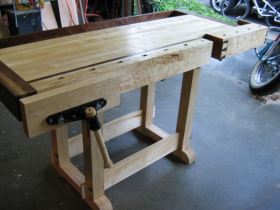

Posts: 785
Paul,
Here's my workbench:
One of these days I'll add some drawers.
The materials were a bit cheaper than what it would have cost to purchase a decent Sohlberg. However, I think it's a much better bench than that (much thicker top, etc.). On the downside, it took a lot of time to make --- probably 60-80 hours. If you are taking time away from building guitars (which you will sell) in order to build a bench (which you won't), it's cheaper to buy one.
My suggestion is that if you have orders to fill, don't hold yourself up by spending a lot of time building a bench you could buy for a reasonable price. On the other hand, if you occasionally find yourself with some downtime or spare time, it is a very rewarding project.
One final thought. If you have the time to build a beautiful and functional bench, it will be a tribute to your craftsmanship to anyone who sees it. That may be worth something. Have you ever seen the Studley tool chest? He was a piano maker who built himself an incredible tool chest --- remarkable enough that it spent quite a bit of time on display at the Smithsonian. I was once watching Norm in a tool-chest episode, and he was showing the Studley tool chest. Norm commented "if he built that kind of tool chest, imagine what kind of pianos he made." There's something to be said for that.

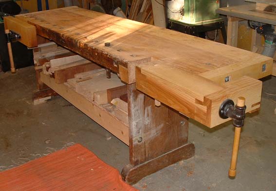

I have a traditional Scandinavian type bench that I bought used and made new tail and side vises for. It is too big for my shop, and I don't use it much for guitar building, but it is great for hand planing and some of the other wood working that I do. Building the vises, adapting the top and base for them and flattening the top was so much work that I don't think I saved much time over building a much nicer and more suitable one from scratch. It is very heavy and I don't mind a ding or hole or two; if it gets too beat up I'll just plane the top down again. I made the vises from some old designs I have seen on other benches and from plans in this book:
The workbench book
Here is my bench
